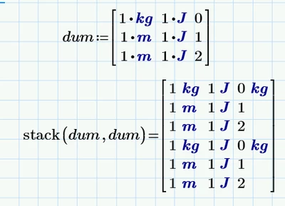

Beware of using the "stack" function with mixed unit matrices containing zero terms without units. Prime seems to "leak" the units from another term to the unitless zero terms:
Given that Prime is fairly pedantic about using units  - even on zero terms- subsequent computations using 0.N instead of 0 will fall over.

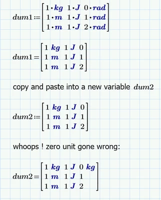

This can unwittingly happen when radians are used, and you expect the value to remain a pure ratio. The get around is to ensure radians are inserted at source - even though Prime strips them off in subsequent results:
If you copy and paste this result, into another expression, the rad unit will get swapped out for another:
However, this is of no help if the zero value is not an angle e.g. a zero count value.

I agree that its a nasty and annoying behaviour and it looks like some leftover from the former SUC (static unit check) which we had in MC15.
You may want to look up the explanation for the two new "pseudo-units" "zero" and "Zero" in the documentation. The doc calls them units, but they are labelled as units !?
You can avoid the undesired behaviour if you use zero (note the lower case z) instead of 0.
Nonetheless - unpleasant and non-intuitive.
I would rather like to get an error if I try something like 1m + 0 =  instead of  1m +0 m =
I guess it would make more sense if "0" would be treated as "zero" and not as "Zero".
BTW, it has nothing to do with the stack function. Simply evaluate dum after you defined it and you will see the same effect.

EDIT: Concerning the (pseudo)units rad and deg
You don't need to copy & paste. If you use an inline evaluation when defining the matrix you can experience the same undesired effect.
GeoffD14-AlexandriteAuthor
May 27, 2023 11:57 AM UTC
Thanks for pointing out the existence of zero and Zero.
Whilst we can type either type of zero, is there a simple way of ensuring the right type of zero is visibly inserted into a generated matrix?
In mixed matrices, where unitless zeros might occur, is it better to artificially assign a unit to avoid this happening?
The stack function aspect occurred when running code to modify values in a mixed matrix. The workaround was to use a for loop to change things element by element - that way the "leakage" was avoided.
Concerning the editing issue, It seems that copy and paste is generally problematic. I invariably use variables to transfer values now as you suggest. In particular, copying matrices where only the visible number is copied not the full accuracy value (unlike, say Excel.). Also, the reported issue concerning the copying and pasting of differential equations. First-time users should be alerted about this practice - "what you see is sometimes different to what you get"
