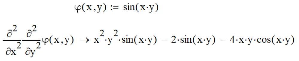

Hi!
How can i write the 4th-6th term in the biharmonic equation, using mathcad 14?
Regards
Sigurd
RichardJAnswer
April 7, 2015
Surely like so:

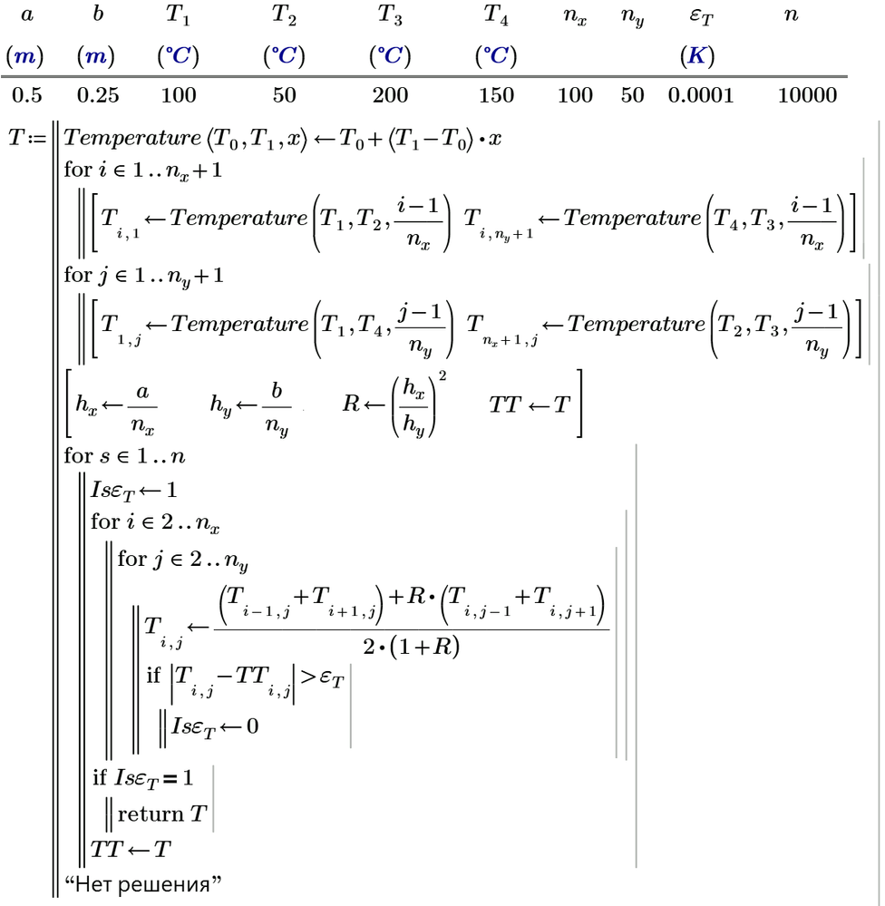

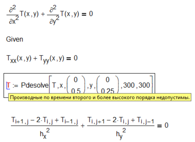

Is there any worksheet available to share? I am trying to solve the same problem but have difficulties with boundary conditions.
Thank you,
Payman
November 9, 2017
My try
18-10-pdesolve-error
November 9, 2017
My solution
18-11-Pde-Plate-Progr
