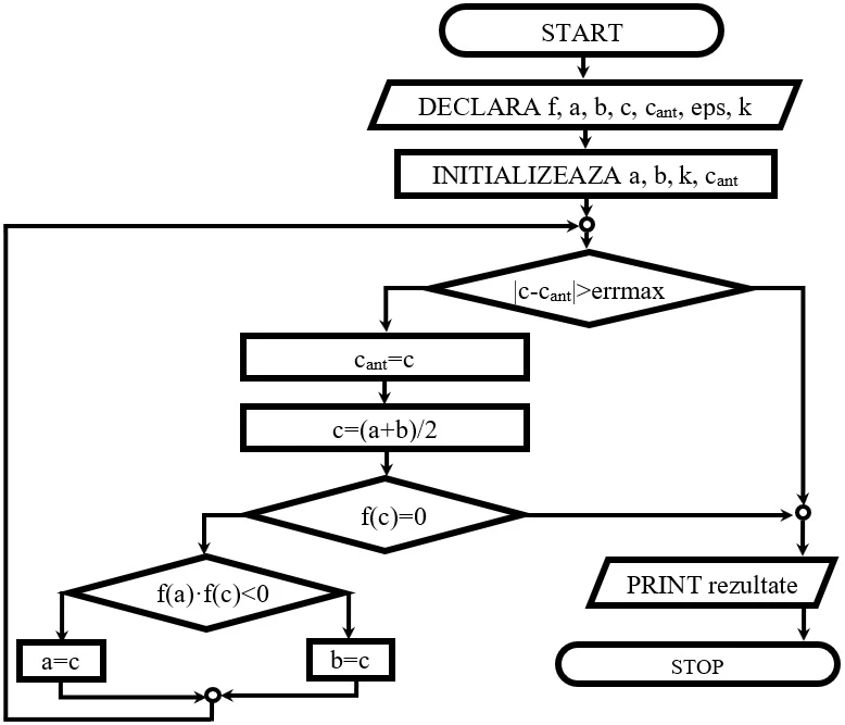

Hello, I want to change an existing Mathcad scheme of solving to another described in a flowchart.    I cannot.   I attached the Mathcad file where I try, and also the Flowchart that I want to implement.

Thank you very much. We are very closed on what I want to obtain.  And BREAK command how I implement ?:
Break, if f(x_i)=0
Also, in the new obtained form (attached) I cannot obtain the table of iterations i  vs  x_i.
