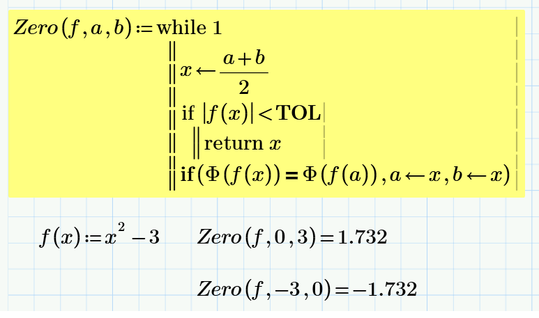

I'm using prime 3 and I want to write a bisection method code but I'm getting an error as follow :
1/ I can't write (i+1) as a subscript for the variable name.
For this problem, I think I solved it by defining a new variable j as (i+1), but I'm not sure if this is correct or not ?
2/ I get an error telling me that the (ai) variable is undefined !!
Please help and see the attachment
Feb 28, 2015 6:32 PM UTC
To index a vector you have to use the vector index (]), not the literal index (Ctrl -).
Feb 28, 2015 7:28 PM UTC
Thank you so much. It is working now.
