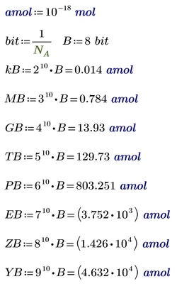

We are obliged to use only SI when writing textbooks, reference books, articles, technical reports atc. And in this system there are no units of information. How to solve this problem? That's how!
November 12, 2021
In your unit system 1 MB = 56 kB.
And the ratio becomes less (worse) for the higher multiples until 1 YB is little more than 3 times a ZB.
Fortunately in my computer 1 MB = 1024 kB, and that 1024:1 ratio holds up to the highest multple.
I guess you need to define MB := 2^20 * B, GB := 2^30 *B etc.

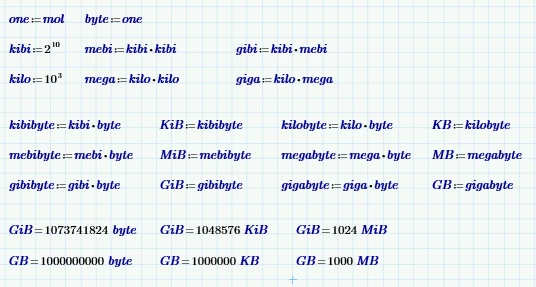

@LucMeekes wrote:
The SI have not included bit and Byte as units. The IEC, in Standard IEC 80000-13, acknowledge that bit and Byte are not units, but are often used as such.
Well, they're right, but they're also wrong.  Technically, "bit" and "byte" are not non-SI units that are accepted for use under the SI.  However, the SI Brochure (Edition 9, current at the date of this message) tacitly recognizes that the bit and byte are units when it discusses decimal and multiples.

@LucMeekes wrote:
The IEC, in Standard IEC 80000-13,  ... propose for power-of-2 muliples to put an i after each prefix, so megabyte is:
MiB= 1024*1024 Byte     in words: One mebibyte
then you get 1024 MiB= 1GiB (gibibyte), 1024*GiB = 1 TiB (tebibyte) etc.
Interestingly the 1000 prefix, normally a lower case k (as in kg), becomes Ki to mean 1024; that's a capital K.
See also https://en.wikipedia.org/wiki/Units_of_information .
I've occasionally used these as units.  If we subvert the mole, we can have:
