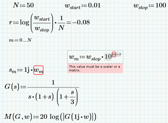

I am new in Mathcad. I would like to plot "Bode Plot" from the given transfer function. I followed one of the attached reference ,but i stucked in between. Please help in this regard.
Please tell me if any other simplest way exist to do so.

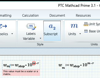

It's a sneaky one, Alvaro; one of the commonest errors that can't be easily diagnosed from a picture and needs a careful look even with a worksheet.   sm is a literal subscript not an index.  Note how the "Subscript" button highlights in the Style ribbon.  The definition on the right has m as a vector index; it is slightly lower than the literal version of m but not sufficiently to make it clear.   I'm not sure that it's worth the effort of lowering the index (given that the Subscript button highlights) ; I prefer the look of the literal subscript position anyway - it's just one more ambiguity in standard math notation and I'd prefer Mathcad (and other applications) to stick to the ISO (or, at least, have an option for strict ISO)..

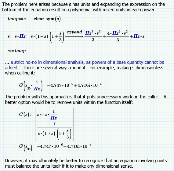

Also I would like to make w_start and w_stop with Hz as a unit. When i used to  do so i was getting an error.<<Please see attached problem2>>

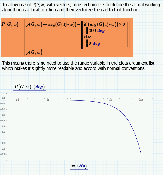

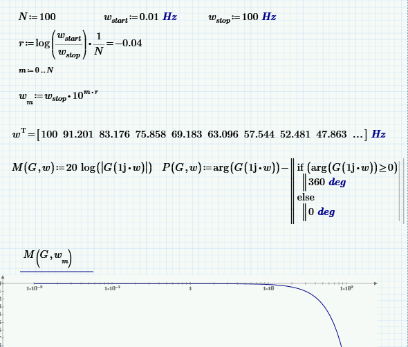

Just as an aside, whilst the wm method works well in Mathcad, it might be slightly less meaningful to an average (but domain-literate) reader.  It would be nicer to drop the indices and just have M(g,w) and w on the axes.  You can achieve this by making M and P automatically vectorize their arguments.

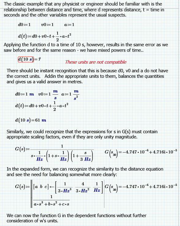

Your new expression for G(s) contains a polynomial in s, which when expanded will result in an equation that has mixed powers of Hz.  Dimensionally, this is disallowed as you cannot add seconds to seconds-squared.    There are several ways of dealing with this: divide s by Hz when calling the G, divide s by Hz inside G and then apply the expression , divide each s in the expression by Hz, or expand the polynomial and divide each power of s by the appropriate power of Hz.  See the attached worksheet.
