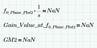

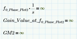

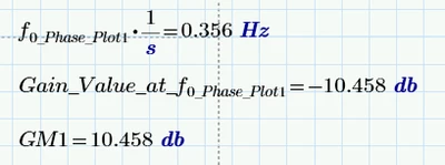

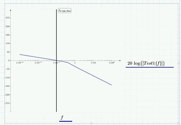

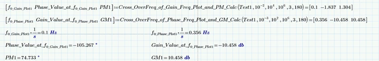

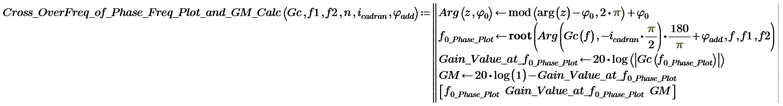

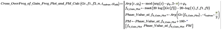

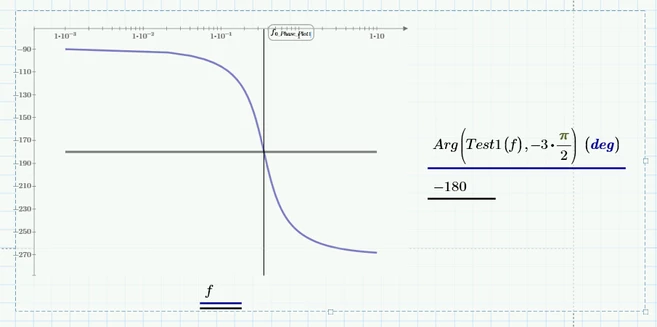

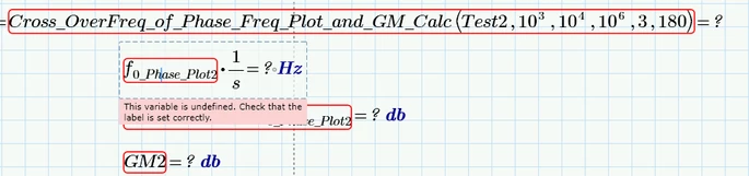

We see that in the case of the function Test1 Arg(Test1) cuts -180deg line, as a result, we can have values ​​for:

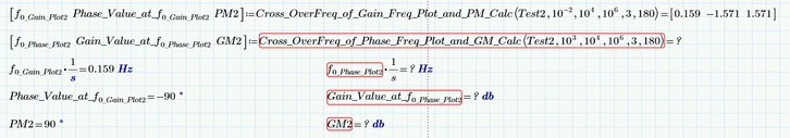

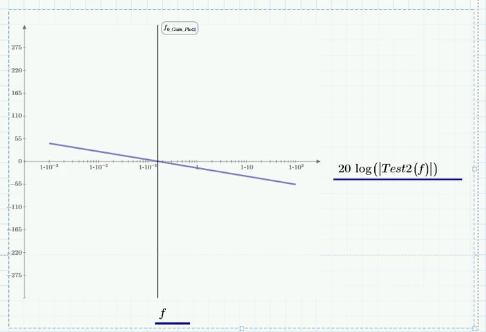

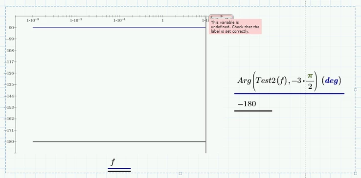

But in the case of the function Test2 Arg(Test2) does not cut -180deg line, and this means that:
or
or

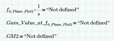

But I get the red color:
The idea is that I don't want to see this red color (although I know from where this no answer/red color comes -> because the graph does not cut -180deg line), but instead, I want to receive as answer one of the 3 options listed above. Is this possible?
Mathcad Prime 8 file attached.
Thank you.

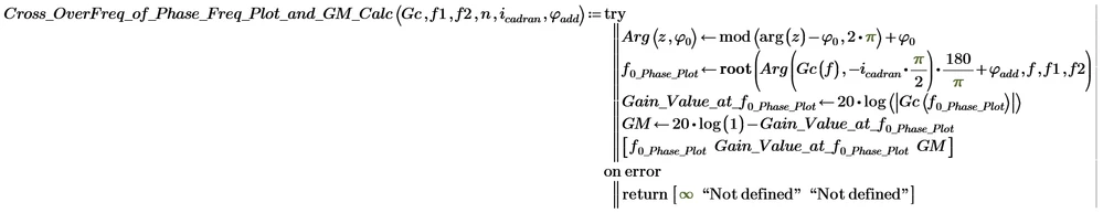

Most easy way is use try on error.
t.t.
