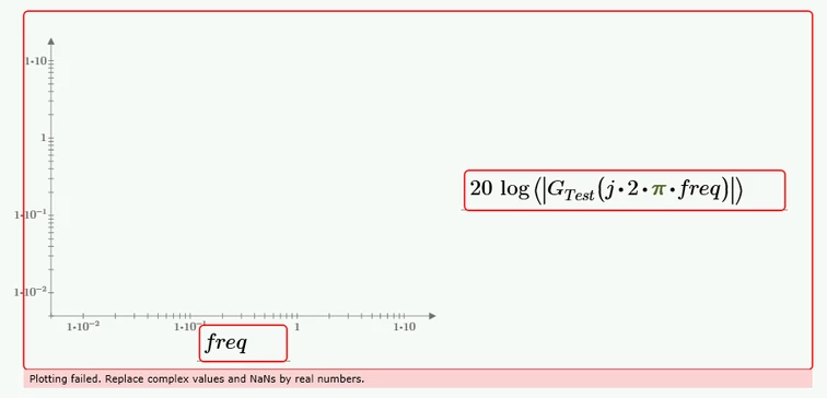

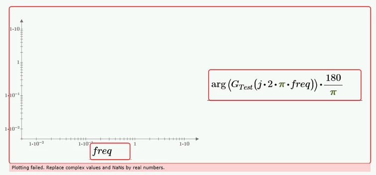

How can I get rid of that error in red below? I want to plot the Bode graphs of amplitude-frequency and phase-frequency in Mathcad Prime 7.

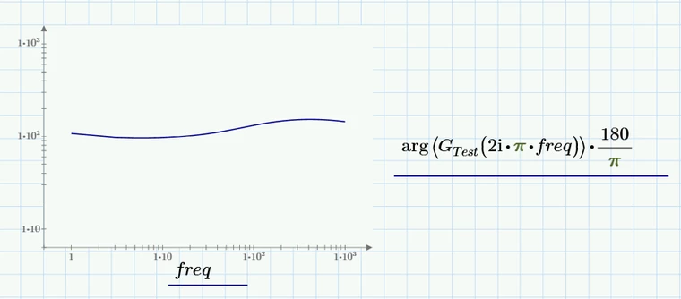

You left freq undefined, so Prime will try to range freq from -10 to 10. Of course that doesn't work on a logarithmic scale. In addition freq needs a unit (Hz or so).
You can solve this problem simply by defining freq as:
But this creates a lot of superfluous points for a log scale. And when you want to go over 6 decades it's not going to work.

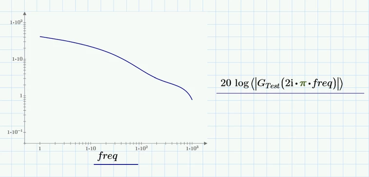

You can use logpts() or logspace() to generate a vector of logarithmically spaced points for freq:
To get 10 points per decade from 10^0(=1) to 10^3(=1000) Hz.
Now you need to vectorise the plot expressions.
You can use the unit deg instead of multiplying the argument with 180/pi, and i is a predefined constant, you don't need to define j.
This gets:
and

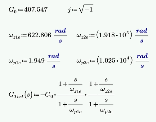

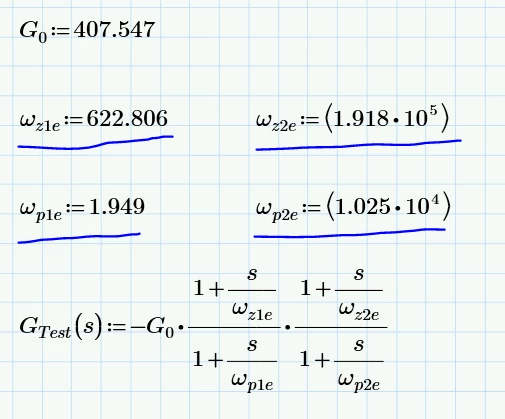

It is a little strange because if I do not put the units (meaning rad/s) for wze1, wze2, wpe1, wpe2 then 1) I do not need to define any freq, 2) I do not need to vectorize anything and 3) the graphs are displayed. Do you know an explanation for this thing?

The reason that the plot works when you strip all units, is because freq, if undefined, gets an automatic range but without units. (The automatic range is -10 to 10 for linear scales, and appears to be 0.4 to 10 for log scales.)
Having units in your omega's but not in your s's causes inconsistent units in the transfer function Gtest, where you add 1 (no units) to s/omega, and only omega has a unit. You're trying to add apples to pears...
