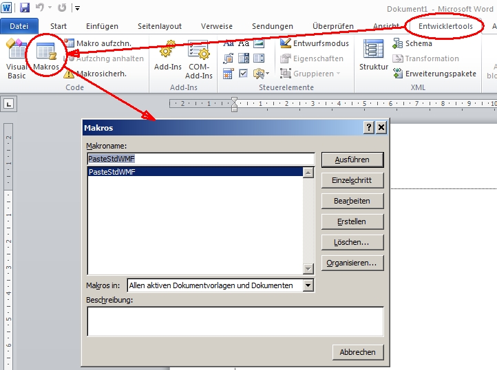

I do it with paste standard windows metafile:
Regards
Ueli
May 13, 2017
Hey, hmm i dont get it right now how to do it 😞
May 15, 2017
In the attached Word-document you will find more instructions and, because I applied the macro, it should be stored in the document and it should become visible to you.
Regards
Ueli
May 21, 2017
Best thx. You helped me alot 🙂
May 21, 2017
hmm i dont see a makro in this wordx file?

Thx i solved the problem with this makro code:
Selection.PasteSpecial Link:=False, DataType:=wdPasteMetafilePicture, _
        Placement:=wdInLine, DisplayAsIcon:=False
Bitmap is too bad quality
The perfect format seems to be Picture (EMF)
