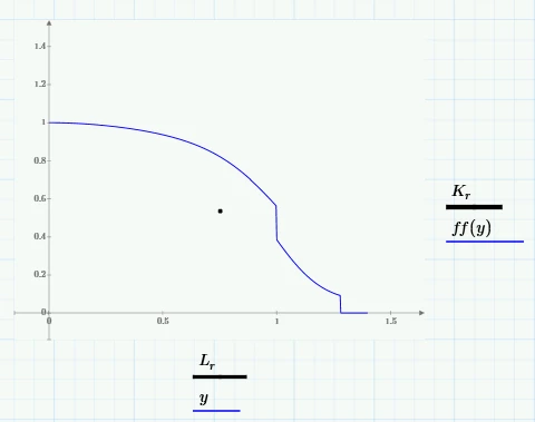

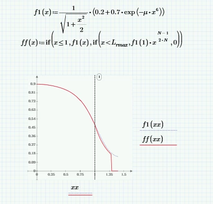

Hello to all,
I am looking to see if anyone has any experience in using the BS 7910 standard or can simply pull me up on my error in the attached.

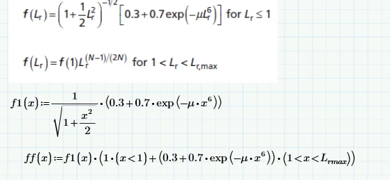

Within the standard there is a mathematical definition for a pass fail curve (where the variable Lr is plotted on the x axis).
Toward the bottom of the attached I have inserted an exert from the standard, my attempt to define this, my result and what I am expecting to see.
Obviously something is not quite right.
Any thoughts or hints welcomed as always.
Andy
