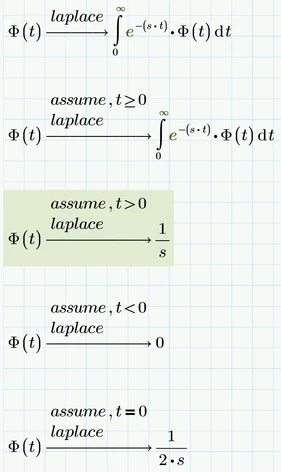

Here is a workaround and some "funny" side effects.

This is NOT a bug. The symbolic answer is completely true.
However it shows an incapability of Prime 6's new symbolic engine.
October 19, 2019
Of course, one can discuss this excellently, whether it is a bug or "only" just inability, if a software claiming to be a math software is not able to evaluate an expression like this. Some may perhaps call it a sham.
However, it is always better if the software just gives up, as in this case, rather than returning an incorrect result, as its the case since Mathcad 14 with various symbolically evaluated integrals.
