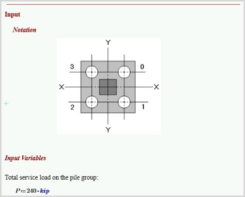

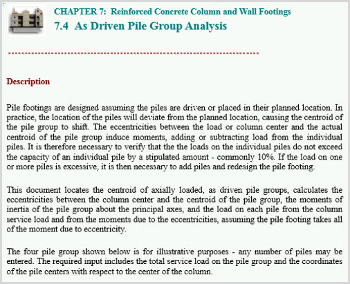

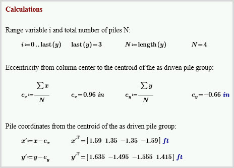

          This document locates the centroid of axially loaded, as driven pile groups, calculates the eccentricities between the column center and the centroid of the pile group, the moments of inertia of the pile group about the principal axes, and the load on each pile from the column service load and from the moments due to the eccentricities, assuming the pile footing takes all of the moment due to eccentricity.
