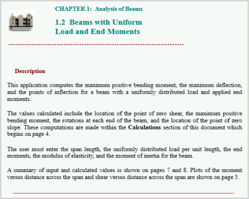

Description:

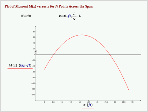

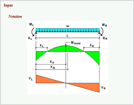

          This application computes the maximum positive bending moment, the maximum deflection, and the points of inflection for a beam with a uniformly distributed load and applied end moments.  The values calculated include the location of the point of zero shear, the maximum positive bending moment, the rotations at each end of the beam, and the location of the point of zero slope.
