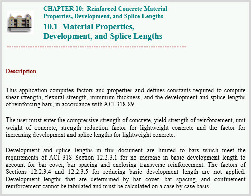

Chapter 10: Reinforced Concrete Material Properties, Development, and Splice Lengths, Part 1
Description:

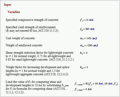

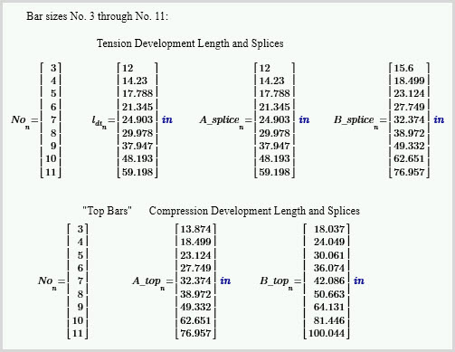

          This application computes factors and properties and defines constants required to compute shear strength, flexural strength, minimum thickness, and the development and splice lengths of reinforcing bars, in accordance with ACI 318-89. The user must enter the compressive strength of concrete, yield strength of reinforcement, unit weight of concrete, strength reduction factor for lightweight concrete and the factor for increasing development and splice lengths for lightweight concrete.
