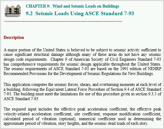

          This application computes the seismic forces, shears, and overturning moments at each level of a building, following the Equivalent Lateral Force Procedure of Section 9.4 of ASCE Standard 7-93. The building must meet the limitations for use of this procedure given in section 9.3.5 of ASCE Standard 7-93.
