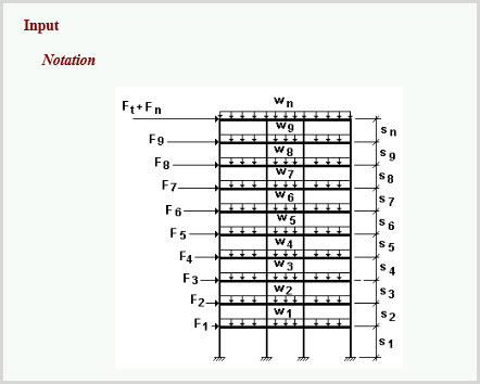

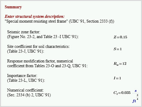

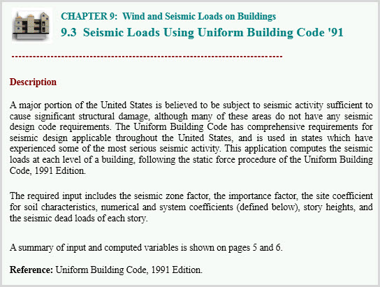

Chapter 9: Wind and Seismic Loads on Buildings, Part 3
Description:
          The Uniform Building Code has comprehensive requirements for seismic design applicable throughout the United States, and is used in states which have experienced some of the most serious seismic activity. This application computes the seismic loads at each level of a building, following the static force procedure of the Uniform Building Code, 1991 Edition.
