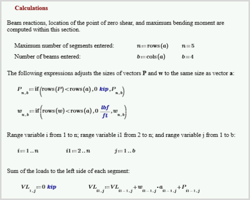

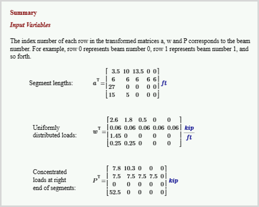

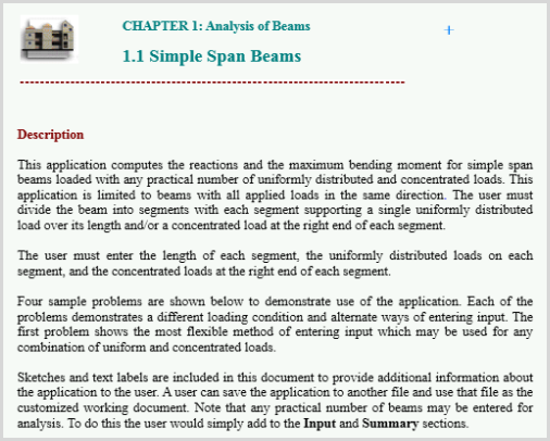

Description:
          This application computes the reactions and the maximum bending moment for simple span beams loaded with any practical number of uniformly distributed and concentrated loads. This application is limited to beams with all applied loads in the same direction. The user must divide the beam into segments with each segment supporting a single uniformly distributed load over its length and/or a concentrated load at the right end of each segment.
