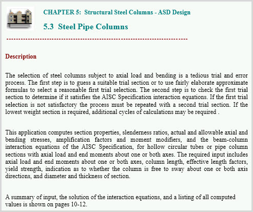

Chapter 5: Structural Steel Columns - ASD Design, Part 3
Description:

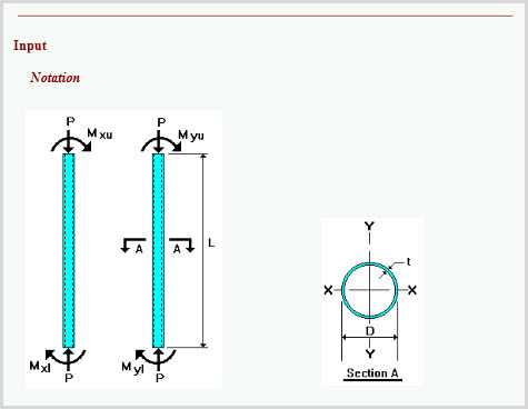

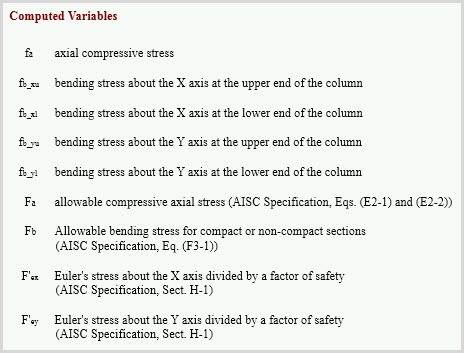

          This application computes section properties, slenderness ratios, actual and allowable axial and bending stresses, amplification factors and moment modifiers, and the beam-column interaction equations of the AISC Specification, for hollow circular tubes or pipe column sections with axial load and end moments about one or both axes.
