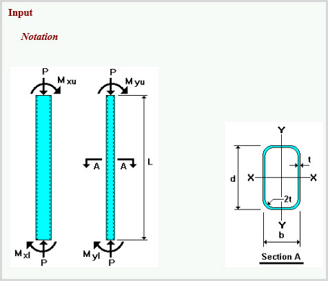

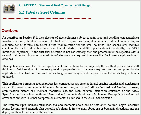

          This application allows the user to rapidly check trial sections by entering only the width, depth and tube wall thickness of trial sections. All necessary section properties and parameters required are then computed by the application. If the trial section is not satisfactory, the user may repeat the process until a satisfactory section is obtained.
