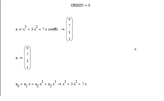

If you want to use it as an operating (calculating) function, then you've already written it:
If you want it displayed as a full-length expression, I doubt it.

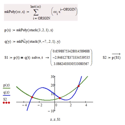

You may also consider writing a small utility function which turns a vector into a polynomial function.
The example below also shows that the names of formal and actual argument must not be the same.
Of course I would not use a confusing naming like the one shown in a real world worksheet.
MC15 file attached
