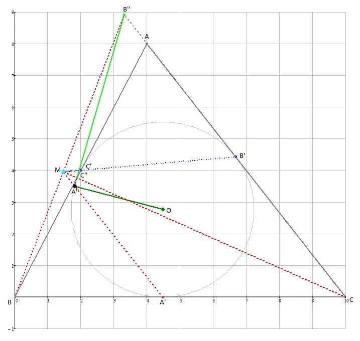

    Hello Everyone.
   With referring to Werner's suggestion and Ttokoro's suggestion on solving with MathCad ( or Prime )
https://community.ptc.com/t5/Mathcad/Butterfly-problem/m-p/848009#M204472
I'm interesting in it :
Given:
Let ABC be a triangle with incircle ( O ), and let ( O ) touch BC, CA, AB at A', B', C' respectively. M is a
arbitrary-point move on B'C'. Lines BM and CA meet at B''. Lines CM and AB meet at C''. Lines A'M
and B''C'' meet at A''.
Prove :
A'' move on incircle ( O ) ( with M move on B'C'. )
     Thanks in advance for your time and help.
          Best Regards.
                 Loi.

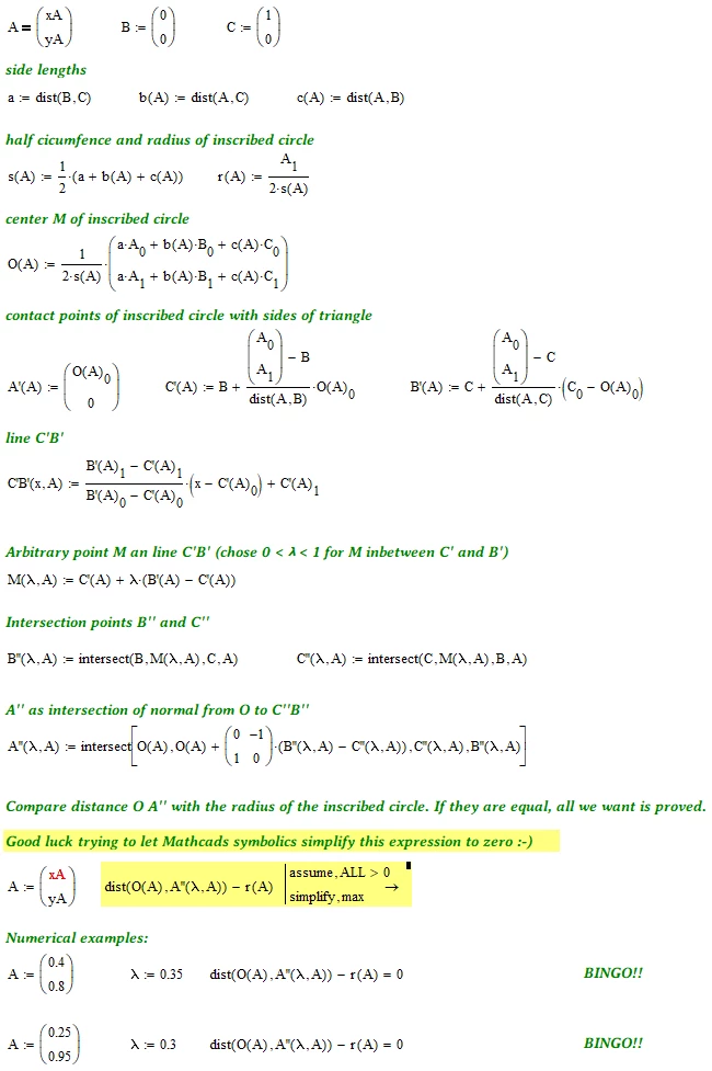

Werner_EAnswer
Here is a brute force attack with Mathcad.
Good luck for trying to let the symbolics prove it! 😈
But as you can see we can at least demonstrate the property for specific numeric values ...
EDIT: modified screenshot and attached file! In the originals the radius was calculated wrongly

Werner_E25-Diamond IAnswer

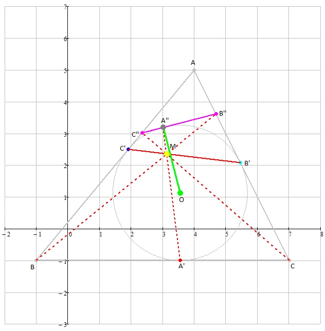

lvl10720-TurquoiseAuthor
20-Turquoise
Many, many thanks for your time and help, Werner.:
