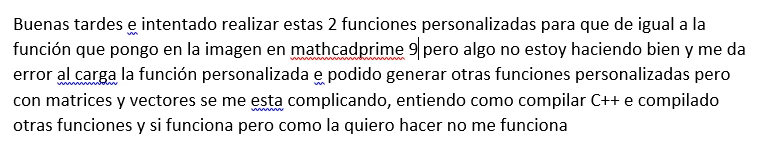

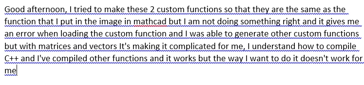

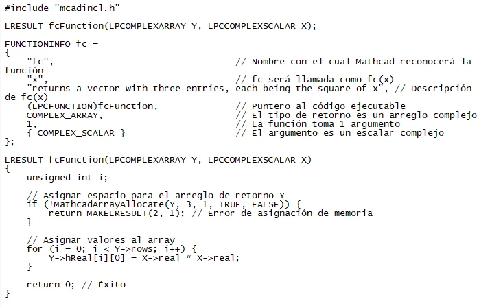

Perfect thank you I have a question @terryhendicott you did it by command promp or by the visual studio program, I comment that I still do not understand how it would be to try to compile it by the visual studio program, by command it works well but I think that by program I do not add well the references etc if or I start from 0 can you indicate how it would be without the command promp thank you greetings
terryhendicott
Jul 23, 2024 1:54 AM UTC
I compile by Borland C++ Builder 12 - paid for or Visual Studio Community 2022 - free.  Both use an IDE to make compilation easier.  I have used these so much have forgotten how to use the command line.  Using  a "*c" file forces c compilation not c++.
Four things to set are:
1)    Directory for include of  C:\Program Files\PTC\Mathcad Prime 10.0.0.0\Custom Functions
2)    #include "MCADINCL.H" in the source file *.c for the dll
3)    Directory for library C:\Program Files\PTC\Mathcad Prime 10.0.0.0\Custom Functions
4)    Inclusiion of the library mcaduser.lib
5)    I turn off wide character strings (optional)
1,3,4,5 are set by options in Project Properties in the IDE (Integrated Development Environment)
2 is in the source file.
