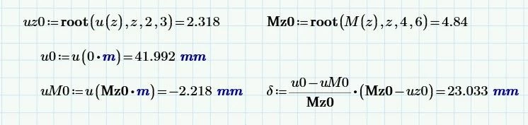

I want to calculate the maximum deflection of a structure subjected to bending. The deflection occurs within the buckling length, defined as the deflection within the points of inflection i.e. where M(z)=0.
I have plotted the moment and the deflection in the attached file, but need further assistance finding the maximum deflection within the buckling length (see page 2 in the attached file).

terryhendicott
Jun 15, 2023 8:53 AM UTC
Like this?
And if you include the small negative deflection at the lower point you get.
Cheers
Terry

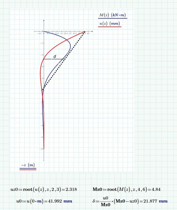

Thank you. What I'm really looking for is a function that automatically plots the dashed line and the "d-line" for any generic shape of the deflection curve.
Jun 15, 2023 12:30 PM UTC
Something like the attached?
Its based on Terrys solution.
You have a confusing mix at the abscissa - two quantities of completely different dimensions (units mm and kN*m).
So I decided for a dimensionless approach - after all Terry already made Mz0 and uz0 dimensionless instead of the appropriate units meter because he used root without units. So all I had to do was to get rid of the remaining units.
