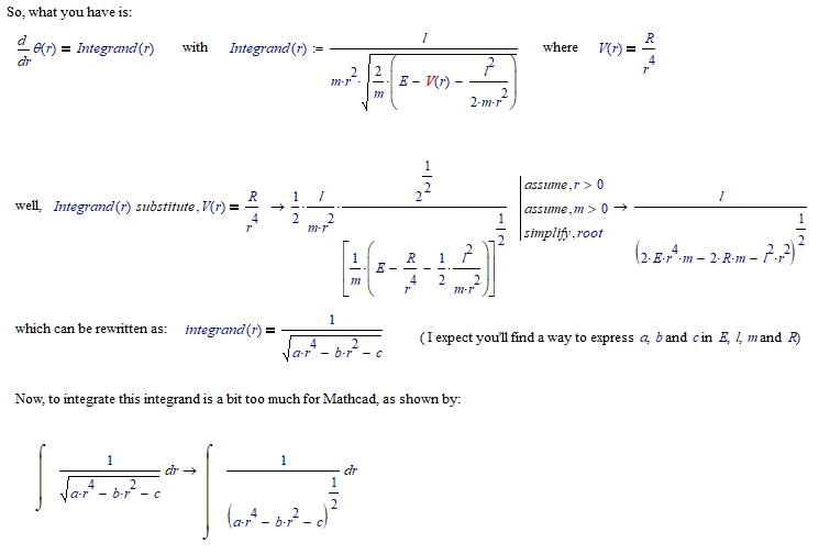

It's not completely impossible:

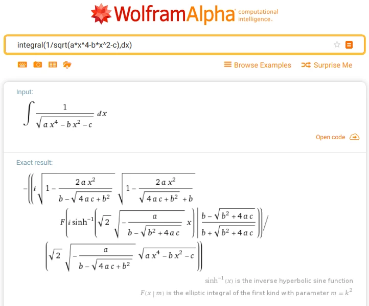

But then there is WolframAlpha:
Now the biggest hurdle may be to have Mathcad calculate the function F, the elliptic integral of the first kind...
February 27, 2019
Great! Thanks a lot!
Best regards
Walter
