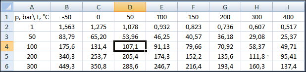

Hallo,
i have a Problem i need to solve fast 😞
Problem:
Density is a function of pressure and temperature
I can create a cloud of points for the density:
                         Temperature
Pressure                 100°          200°          300°
      100bar           Density      Density
     200 bar
     300 bar
          etc
My problem is now, how can i calculate a Density Function depending on these Input Points?
Can anyone help me ?
Thx 😃

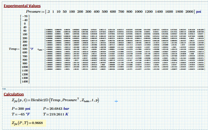

Look up "Curve Fitting and Smoothing" and "Interpolation and Prediction" in Help.  You may find the cspline 2D example of particular interest.

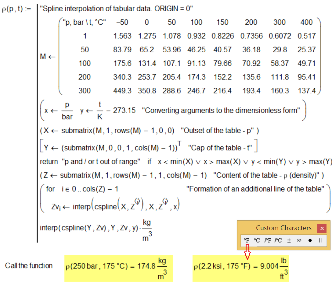

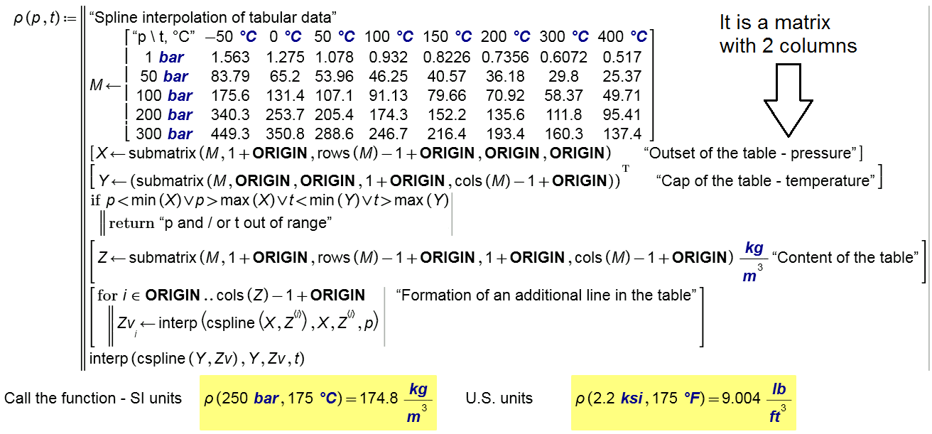

I assume you are ok interpolating between the data points you created.  If so, this should be all you need to do:

Yea there is no possible equation i think its from measured data.
Its a mixture of Ehthylen and solid  30% Propylen Particles or so.
A polynomic Interpolation or fitting is what i needed.
Real gas.
@dferry its exactly what i needed THx!

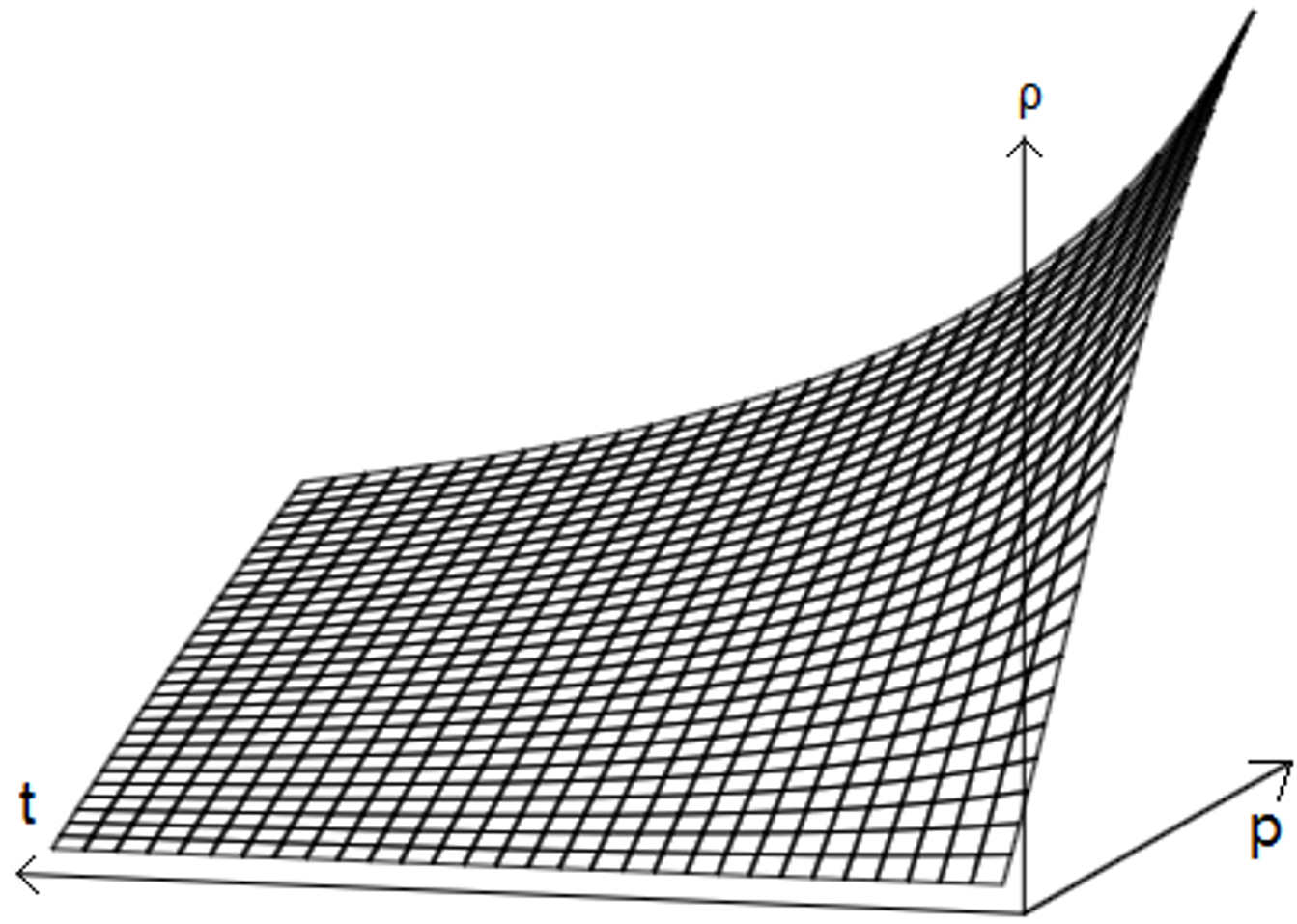

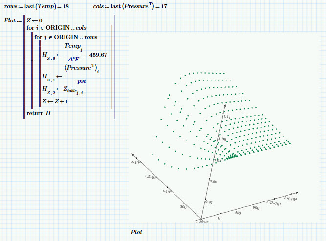

October 26, 2016
I got to thinking about plotting the data.  Came up with this.  Maybe someone knows a simpler way.  I couldn't figure out how to get a mesh; not sure if it's possible, particularly in Prime.
fyi, I had to remove the units because it won't plot otherwise.
