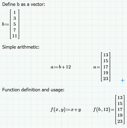

I am new to MathCAD and am looking for help.  Say I have a formula with two variables (a=b+c).  I want to calculate the value of "a" for 100 values of b.  So, I need 100 answers, one for each value of 'b." I am hoping to get an answer in the form a 100 rows x1 column table for values of "a." I greatly appreciate your help! Thank you.

January 7, 2016
So c is a constant, right.
Create a function f(x,y):=x+y (of course you can also use b and c instead of x and y, if you like).
Create a vector b (NOT a range variable) with the hundred values
Than call a:=f(b,c). If this throws an error or just to be on the safe side, you have to vectorize the function call f(b,c).
How you do this varies depending on the version of Mathcad you use (real Mathcad 15/below or limited Prime).
You can tell its a vectorise call by the arrow over the function call.
Regards Werner
January 7, 2016
Here is an example:
If your b is really supposed to hold 100 elements, I hope you have an algorithm to define its values, or you can read the data from a file.
To use an algoithm:
