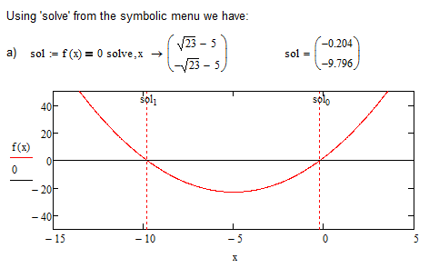

I have a question on the graphing of a function. Lets say my function f(x) is x^2+10x+2.
Now I need to write a graph of the function which is no problem.
a)The second part is to make Mathcad calculate the points where the graph intersects with the x-axis.I can see from the graph what the right answers are but I cannot figure out to how to make Mathcad to calculate them?
