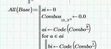

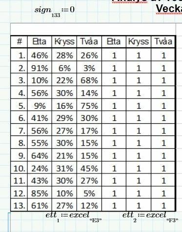

I have a Mathcad sheet that calculates a 13X3 matrice and then returns a 13X(3^13) matrice. It is a lot of calculations. I have a HP computer with Intel I7 processor and 64Mb RAM. Task manager say it uses about 10-12% of processor and 3-5MB of memory. So far it´s been working on this for about four hours, and it´s not finnished.
What is missing to make the calculation go faster? Are there any parameters that I can change in Mathcad so it uses more power?

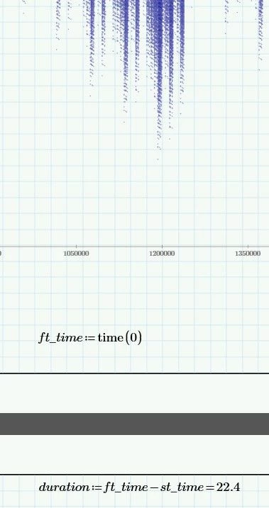

Filled out all the ones and with the two changes defining large matrices to full size get 25 seconds
Trick is to calculate the size of Combos before hand

Could you enclose the worksheet then more guidance can be given to speed it up.
