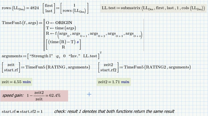

I have a MCP sheet that pulls from some matrices to perform basic calculations that takes over an hour to complete. I would like to improve this significantly if possible. I tried to rely on built-in functions (e.g., "lookup") when possible for calculation efficiency.
The main calculation (image below) uses data from three matrices (36177x9, 2412x9, 1206x12) to perform basic +-x/ calculations resulting in a 216619x8 matrix. At the end of the sheet, there is some red text that helps point this out. File attached.
If anyone has tips for how to improve calculation speed or is able to help me optimize this process, I would much appreciate it!

Sorry, had a quick look at the sheet but did not find the time to study in more detail what the nested loops actually are doing to see if it could be achieved with less effort.
EDIT:
Got rid of the "matrix" function calls (and also of stack3 and stack5). Speed gain is about 50% or more (depends on the size of the input matrix LL)
See the speed comparison here for one call with the full matrix LL.Des:
Have not tested the new RATING2 function in the section you disabled which you say took more than one hour, but I guess it should help at least a little bit to cut down calculation time.
Prime 9 file attached
