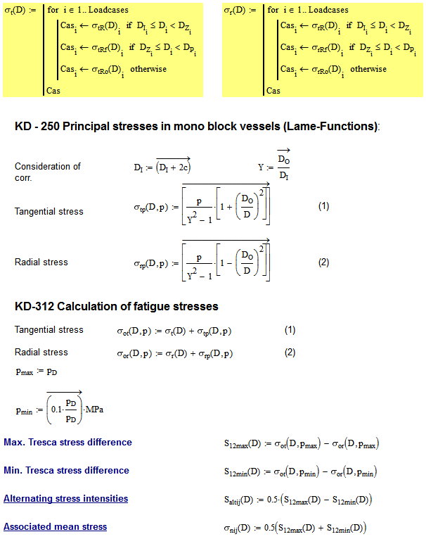

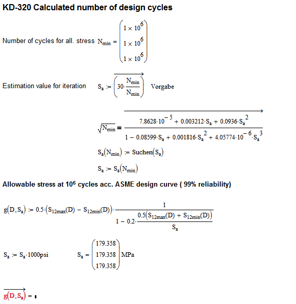

Hey,
i would need a short another help of you.
This is a par tof my Calculation:
Now my question is,
how is it correct to write the fomulas with that variable?
I dont get rid of this.
Thx !
23-Emerald I
January 5, 2017
What are the units of the functions of D?
You may just have a unit incompatability issue.
January 5, 2017
D is a diameter and has mm
January 5, 2017
maybe i found my problem i need the other variables too.
f(A,B,C,D) ---> all variables need to define in the function. I only used D as variable but i have a few other parameters too which defines the function
