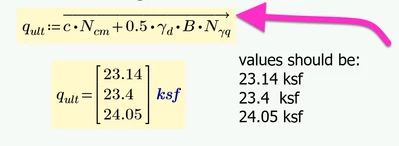

calculations end with incorrect results
Not sure why the results at the end are incorrect.  There do not appear to be any mathcad errors.  Any help would be appreciated.
Werner_EAnswer
March 24, 2020
You have to use vectorization in the last calculation:
Werner_E25-Diamond IAnswer
March 24, 2020
idahoan12-AmethystAuthor
March 24, 2020
Dear Werner,
Thank you very much!
