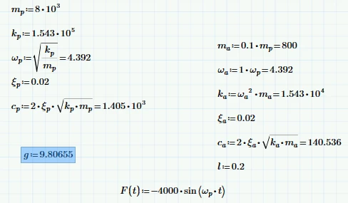

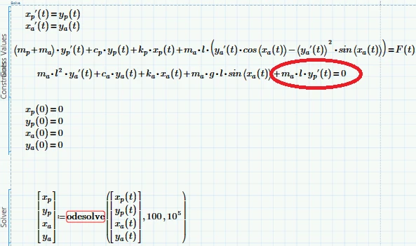

Werner, I'm using the MathCad Prime 5. The worksheet is been sending
November 7, 2019
The error message is not really helpful.
When you look for "odesolve", the help states
"The ODEs must be linear in their highest derivative term"
