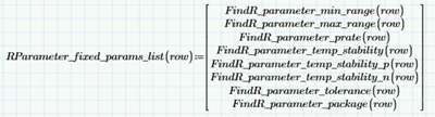

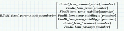

There are 2 Matrices defined as below:
I want to create a function with these 2 matrices as input, to compare the values of 1 matrix to the other.
How can i do this?
I tried doing it like below, But it seems that a function depending on another variable (pnumber or row in this case) cannot be given as an input to another function.
IsParamMatch(RBoM_fixed_params_list(pnumber),RParameter_fixed_params_list(row))

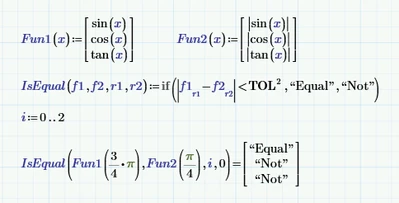

Indeed, you cannot define a function where the parameters to the function are function calls.
But you can define a function where the parameters to the function are function names. So simply define:
IsParam( f1 , f2 ):=if (f1=f2 , <whatever> , <orelse> )
Then you define values for pnumber and row, and you call that function with:
IsParamMatch( RBoM_fixed_params_list(pnumber) , RParameter_fixed_params_list(row) )=
and it will produce <whatever> in case RBoM_fixed_params_list(pnumber) equals RParameter_fixed_params_list(row), and it will produce <orelse> in the other case.
For more flexibility you could define:
IsParam( f1 , f2 , p , r ):=if ( f1(p) = f2(r) , <whatever> , <orelse> )
and call it with:
IsParamMatch( RBoM_fixed_params_list , RParameter_fixed_params_list , pnumber , row )=
Here's a small example:
P.S. You should attach your worksheet...
May 4, 2025 4:25 PM UTC
Hello!
What is "IsEqual"?
Best regards,
Sergey
23-Emerald V
May 4, 2025 8:02 PM UTC
The name of the function I defined just below the definition of Fun1 and Fun2.
