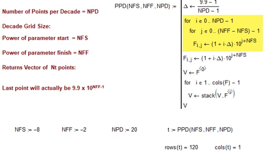

Can a vector have arguments in its definition
Attached are two Mathcad 15 M050 files.  The Test_SUBROUTINE worksheet works; however, Test_FUNCTION worksheet does not work.  I assume it is because a vector cannot have arguments?  I really want to use the Test_Function worksheet as a reference sheet in other programs.  Any help is appreciated.

You cannot use range variables inside a program like you do on worksheet level.
You have to use for-loops instead.
This small modification makes your function PPD work as you expected:

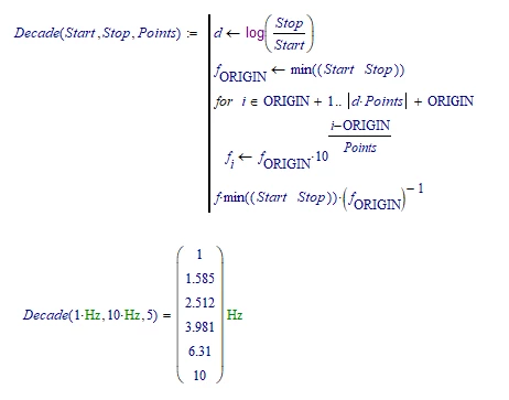

A vector is not a function, so you cannot associate parameters to it. But you can define a function (with parameters) that results in a vector.
I see you're trying to create a function that does something similar to the built-in logspace() function...
That wasn't available in Mathcad 11, so long a go I created my own version, which accepts units:
It's attached. If you can't use logspace() and still want to create your own function, you can use and/or adapt my function.

March 6, 2019
Werner,
Thanks much.  I thought I had done that in one of my trials...apparently not. 🤔😩
Thanks again.
