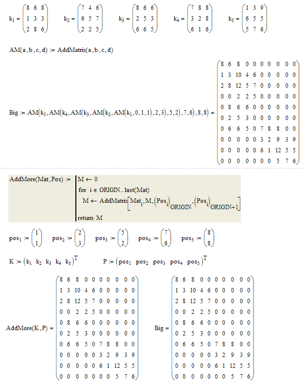

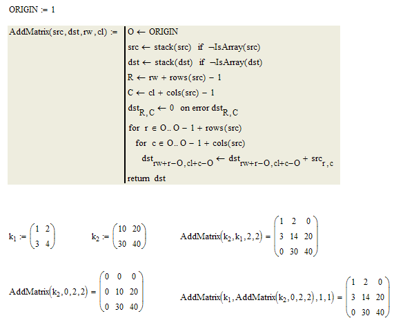

February 27, 2017
Oh! Just see that I am way too late.
But here's my attempt, for whatever its worth. Its very similar to Luc's but I got the impression that you want to add the new matrix rather than replace the old values. That could be also very easily accomplished using Luc's approach. Basically both are the same but my routine automatically enlarges the destination matrix if its too small.
