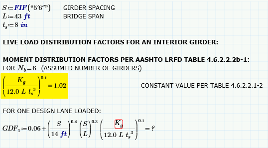

In the highlighted equation, I am attempting to define an expression with a single value.
Is this possible or should I first solve for 'Kg' as all other variable are defined?
Other tips on the best way to do this?
TIA,
Kevin
November 23, 2015
If you have all the other variables it should be relatively easy to solve for K.s.
You could put both equations into a solve block and solve that way.
Mike
November 23, 2015
You mean like this?
Yes, that's possible.
