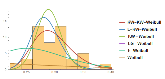

can i get a graph in mathcad lik that?
Hello every one>
i need  a graph like that using Mathcad, Can you help me please?

You can produce such graphs with Mathcad.
I assume that the bar graph is from actual data that you have. What is the intention and the meaning of the various weibull curves?

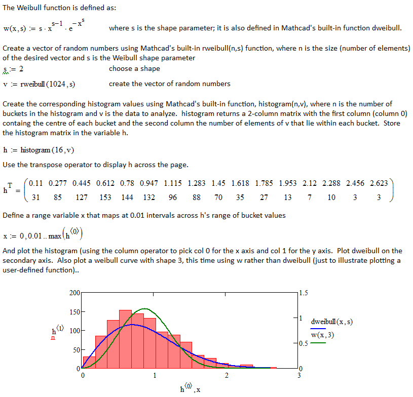

Something like the attached?  (I've used arbitrary data of course).
