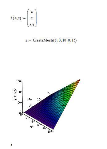

Can I plot a function containing unknown constants in mathcad?
example f(x)=ax ,
I want to plot for any variable of a

Apr 27, 2015 4:24 PM UTC
You can't really expect Mathcad to plot without knowing one or more values of 'a'!
However, you could plot a surface using a 3d plot for a specified range of values of 'a' and 'x'.
For example:
