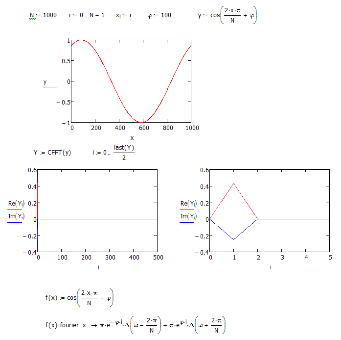

Thanks you very much for the quick answer:
How to create the sample values of the original waveform, defined in continuous time?
To do the DFT I need a sampled waveform, which can be represented by a list of values:
Example: Cos(2PI/N); Cos(2*2PI/N); Cos(3*2PI/N).........Cos(N*2PI/N)
This list of numbers forms a vector. So, my problem is how can I generate this vector?
Probably a piece of cake, 🙂 Am I right?
Having this vector, I can probably do the FFT as you indicate above?
So the FFT (DFT) needs to generate a N x N matrix, but since my input is a N matrix, perhaps the FFT automatically generates the right N x N Fourier transform matrix? Is that so?
Would the output then be another N matrix? That will be another big array of numbers.
Can I plot it?
February 5, 2016
Define the number of points, create an index variable, fill the vector x, calculate the vector y, FFT it, plot the real and imaginary parts. However, if you are starting with a function, rather than measured data, Mathcad may be able to give you FT of the function (i.e. symbolic FT, not DFT). Doing this kind of thing in Mathcad really is an order of magnitude easier than doing it in Excel. Excel is great if you want to look at tables of numbers. I.e. if you are an accountant. For science and engineering calculations it is seriously underpowered.

Example attached (Prime 3.0)
