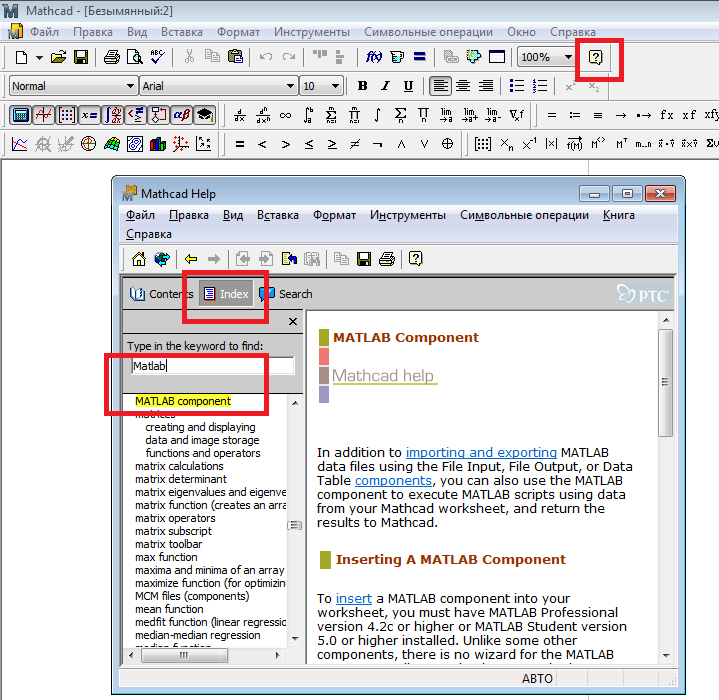

You're talking about regular Mathcad (14/15) or Mathcad Prime?
For regular Mathcad version (quote from "Mathcad Help", F1 hotkey): "in addition to importing and exporting MATLAB data files using the File Input, File Output, or Data Table components, you can also use the MATLAB component to execute MATLAB scripts using data from your Mathcad worksheet, and return the results to Mathcad".
