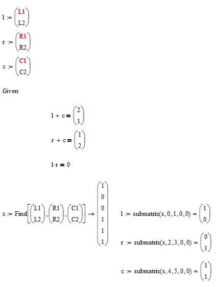

Hi all,
I've been working on a problem and to be perfectly honest I don't know if there is a symbolic solution or how to check whether it can be solved in all cases but in any case I know it can be solved numerically for at least the values given in the attached worksheet. Also I'm not sure how to turn this into a symbolic solution (though I have tried). Specifically I wanted to constrain the problem to work with 2D vectors since I'm not sure if the problem would be solvable with more complex vectors (perhaps it doesn't matter). I'd be interested on your thoughts on this. My linear algebra isn't all that strong.
It involves some simple 2D vectors:
a = l + c
b = r +c
and l and r are orthogonal such that l dot r = 0
I want to find c and hence l and r given a and b. On the face of it, it seems to be 3 equations with 3 unknowns but I don't know if the third equation "counts" in this regard.
Looking on the coordinates it rather seems to me that you have 5 equations and 6 unknowns.
The symbol processor finds no solution (simply type x --> after the solve block).
As you have more variables than equations you can add an additional constraint - try |c|=2 and you get another solution. But there seems to be a rather small range for your additonbal wishes: |c|=1 finds no solution, e.g.
The problem with symbolic solutions of vector equations is that the symbolics does not use guess values and therefore does not know anything about the dimension of the vectors used. So most of the time you are an the safe (but inconvenient) side if you rewrite your equations using the vector components or at least define the vector beforehand using symbolic elements (L:=stack(L1,L2), etc.)

So I worked further on the sheet and got some weird results using symbolic eval. See my comments in the attached sheet.
At least we can say that we have an infinite number of solutions (the system is, as I already stated, underdetermnined) we get by varying a variable in a specific range which depends on your vectors a and b. The symbolic closed solution is attached.
If you intend to apply it on more dimensions or more complex equations - good luck! 😉
