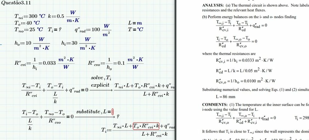

Can someone help me with this resolution Sketch ?
Can someone help me with this? I am trying to replicate this resolution on MathCad but I am doing something wrong or not using the right functions to solve it. Can someone tell me what am I doing wrong? Thank you in Advance.

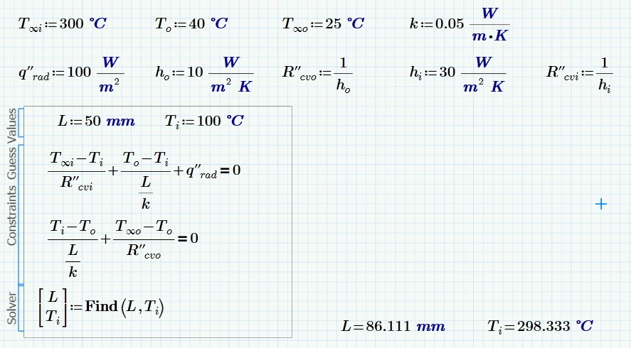

You have a system of two equations in L and Ti. To solve this system symbolically, you would have to put the two equations in a 2 x 1 matrix and then uses "solve,L,Ti".
But Prime would choke on the units, because the symbolics are not unit aware and treats them as unknown variables. Bad, because the "unit" °C is not a simple factor but a conversion function.
Better you use a numeric solve block as shown below:

Be careful with temperature units--there are two types: temperature degrees Kelvin/Centigrade and Rankine/Fahrenheit and delta temperature.  Some of your values need to be deltas.
See if the attached file helps.  I couldn't see a value for Ti, so I couldn't solve for L, but you can create a function.

Thanks for the Tip! The question doesn't give the Ti. It seems that can be solved simultaneously using both equations as shown in the paper.

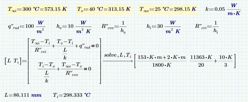

Here is a way to do it with the symbolic solve command.
The trick is to get rid of the °C conversion function by providing all temperatures in Kelvin. This is achieved by using an inline evaluation after the assignment (yellow shaded areas)
Rodyxd1-VisitorAuthor
January 3, 2018
Amazing! Thank you!
