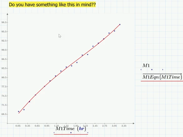

  1.  You write "Time vector to apply equation over (Equation doesn't work when using OptiTime, why?)"
    I am not quite sure what you mean. Maybe you confuse "range variable" and "vector". They are quite different things even though Prime unfortunately displays them the same ways. What you get from Excel is a vector. What you define by tt:=t0,t1 .. t2 is a range!
    Whenever you feed a vector as argument into a function and expect Prime not to make vector calculations but to take every single element of that vector, apply the function to it and collect the results in a result vector, you should use vectorization (shown by the arrow over the expression).
  3. This mix of range and vector does not work.
    Guess you are looking for something like this:
    Again you have to use vectorization. Additionally it seems to me that you have to divide those unitless (why?) values by 3600 as they look to me like values of seconds and M1Eqn expects unitless values in hours.

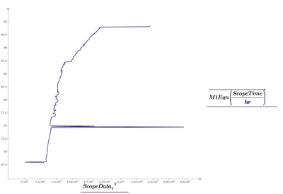

December 9, 2020
Thanks!  The two big things I was missing here were the difference between range variables vs. vectors and using the vectorization symbol when evaluating M1Eqn.
Everything works now!  This is the graph I was looking for in the end for those interested; it can relate scope data to the measured variable in the experiment.
Not using units on the X or Y axis does hurt my heart, but the X-Axis units here are Analog-Digital Scope Counts (or bits, which I don't think is a unit in mathCAD) and the Y-Axis units are % saturation of the sample.
In any case, thank you so much for the help, I really appreciate it.
