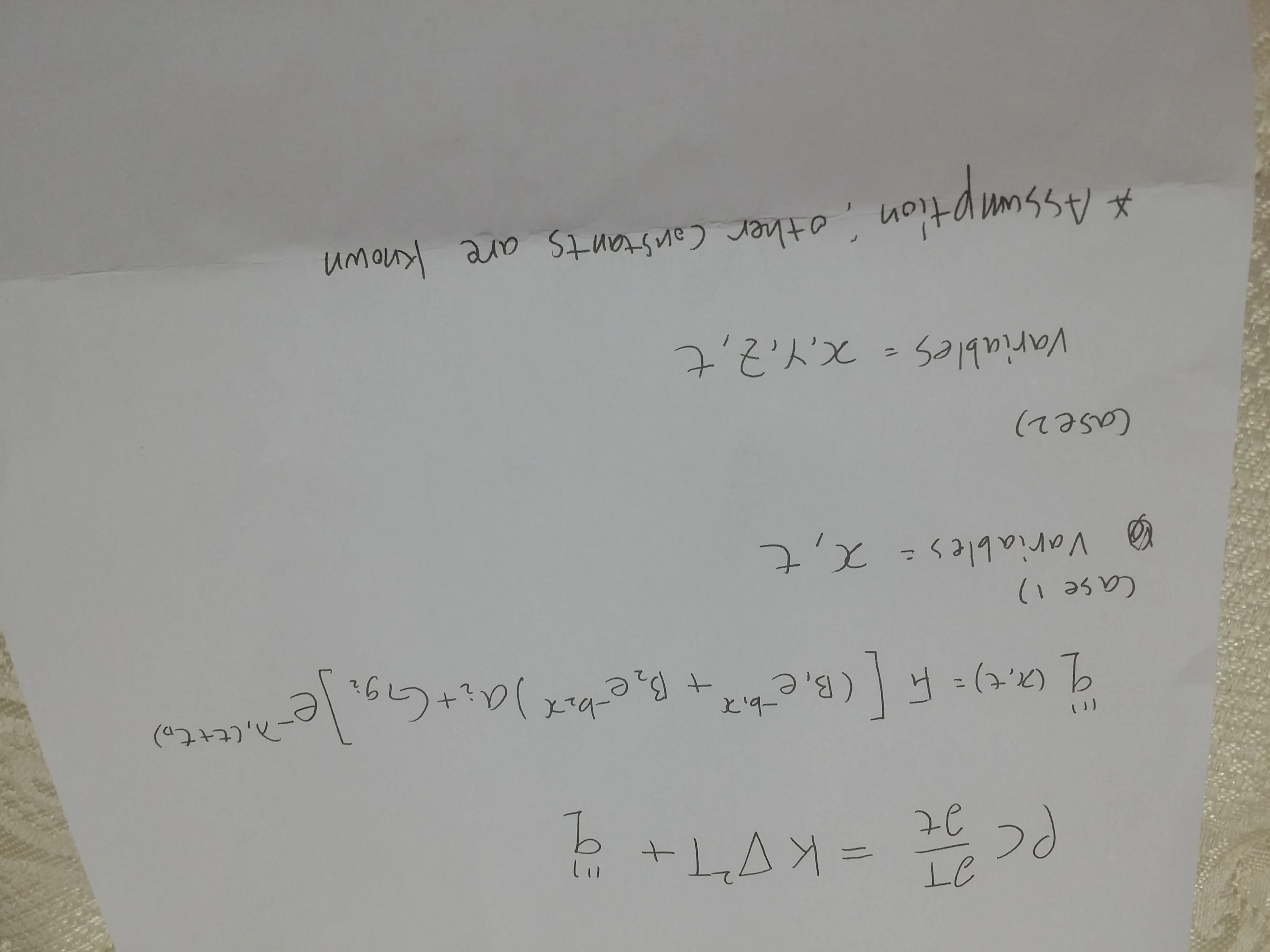

Can this PDE be solvable with Machcad?
I am struggling with a heat equation which has very complec heat generation term.
In the attachment, T is temperature, x,y,x are axes perpendicular to each other, t is time, and other parameters are assumed to be known.
Here, what I want to ask is
1) Is this PDE solvable with Mathcad (w.r.t case 1 and case 2)
or do I have to other softwares like c++, matlab
2) If so, is there anybody who is willing to teach me the code?
I would appreciate it if anybody give me an answer.
Thank you.

I would not say immediately that it's not solvable using Mathcad.
But please provide a Mathcad worksheet to prevent mistakes in erroneously interpreting your handwriting.
Also, while I know the divergence operator, I'm unsure how to interpret it squared. Would that mean you want to solve:
or:
And finally the last term between the brackets of the q(x,t) function, I cannot make anything of it.
Del squared is the Laplacian, and your second form is correct.
23-Emerald V
Thanks Rich, just found that out.
Now we need two boundary conditions for the first case...
