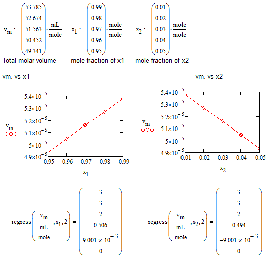

can you try solving the last two parts
i am supposed to
generate  two graphs which i did on vm.x1 and the second of vm vs.x2 and comment on the trends observed
2.develop a 3rd order polynomial fit of vm vs. x2 and use this fit to predict values of vm at the x2 values of 0.06,0.07,0.08,0.09
3.find the value of the derivative of the 3rd polynomial fit function with respect to x2 (use the values from the original x2 data).

this is great, you did real good, can you complete the question by taking the derivative of the result you obtained please
3. find the value of the derivative of the 3rd polynomial fit function with respect to x2.
4. aslo can you expand the graph of x2. vs vm so that the values of x2 are between 0.01 to 0.09 so that i can predict the values vm using the polynomial fit please
can you attach the mathcad file so that i can manipulate the data. i am using mathcad prime 3.1
Thank man.

"i am using mathcad prime 3.1"
Does not match with the photograph you show in the other thread, nor with the attachment to your first post in this thread. You're using Mathcad 15, not Prime.
