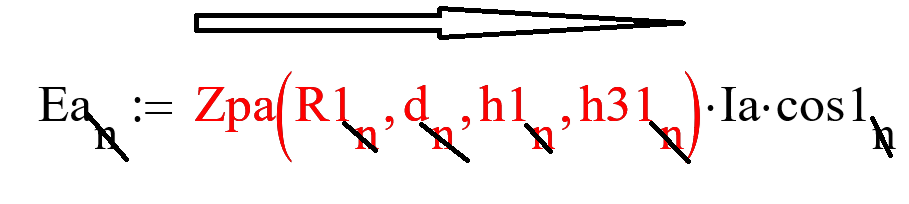

Try to vectorize the function call to Zpa. But then d should be the sam size size as the other vectors!
But its hard to debug a picture! We don't see what the exact error message is. We cannot trace back the error. We don't see if the integral/function works with other single value, we don't see what R1, gamma etc are,l dont see the difference between R1 and R2 or R3 (where it seems to work),   ...
Why don't you post the worksheet?
February 4, 2017
Try please the vectorization operator:
February 4, 2017

I was able to make the integral array evaluate symbolically but it is a bit tricky and you might consider using an integral from 0 to 10^3 (or any appropriate high upper value) and evaluate it numerically.
1) I added
at the top of page, because the symbolics don't know anything about units like degree and it helps the symbolics to evaluate the expressions without thinking that deg is an unknown variable.
2) I added a dummy line in the expression where Ea is calculated. This ensures that the symbolic evaluation is done inside this "program". I also added the "simplify" command:
We cannot use vectorization because the five vectors are not of the same size.
3) Ea still is not an array of true numerical values but we can turn it numerical by reassigning and numerically evaluating the array:
Now we are done and Ea is a normal array of numerical complex values:
