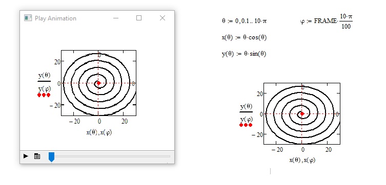

I followed the instructions in the User’s Manual to create an animation of a spiral. When I clicked on ‘Animate’ in the ‘Record Animation Dialog Box’, nothing happened. Subsequent attempts brought up the message ‘Error initialising video stream’.
Where am I going wrong?

I selected Record Animation, then the area, then Animate. The result is below
April 25, 2017
So it looks you are doing it the right way.
Have you changed ("options") the default codec (default: Microsoft  Video 1) to something else ? Most codecs offered are for decoding and will throw the same error you encounter if chosen for encoding.

Hi Ian Darney,
you could do so:
Video Link : 7783
April 25, 2017
I can not see the animation
Convert please avi into mov and then put it here!
April 25, 2017
I do not have the right software.
... it's so simple that you do not waste much time doing it yourself again.
