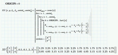

7-Bedrock
Aug 18, 2022 8:36 AM UTC
Hi thanks for the reply. I have manage to get somewhat in the right direction.
This Is where I am now. Its says that the variable is undefined.

23-Emerald V
Aug 18, 2022 8:32 AM UTC
1.
You've types square brackets in a simple expression. Square brackets cause the creation of an array (vector or matrix). I don't think you want an array there:
2.
You've enclosed an assignment in brackets. That is what the error message points to. What exactly is the assignment you want to make to the elements of the arrays X and Y?
3.
The first index into an array is set by the Built-in variable ORIGIN. ORIGIN = 0 in your sheet, but your program/function assumes it's 1...?

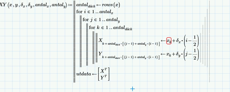

SK_103360457-BedrockAuthorAnswer

23-Emerald V
Aug 18, 2022 8:38 AM UTC
You should attach the worksheet,
Your expressions suggest that x is an array. The unknown variable is x.k (x with subscript k , instead of the k'th element of x. You should type x[k to get that, not x [Ctl _] k )
Note that you supply y as a formal parameter to the function but you do not use it...
Your utdata attempts to use the transpose of the vectors X and Y. You CANNOT use an exponent T to get the transpose. Check the Operators for the transpose operator.
After some editing I got this.
Is this what you would expect?
