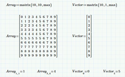

The documentation is so absurdly poor for Mathcad i cant believe i have to ask this and or cant find it on the web.
How do you access data in an array!
I want to create a simple vector and then access bits of it later!! i can not believe this syntax is not available
Array(100,100):= 0
then i simply want to read or write to say element 1X1
So i want to display
Array(1,1) =  0
And have it show zero
Why is everything 10 times harder with mathcad then it needs to be.
September 3, 2020
Mathcad or Prime?
(Not that its much different regarding creation and access of vectors and matrices, but it helps showing you the right stuff.) Both Mathcad and Prime have an online help that you can consult, but of course this forum is quicker.
Anyway, here is Prime:
