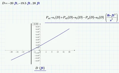

I am trying to plot a function which is dependent on 1 variable.  The attached worksheet calculates the required depth of embedment in soil for a cantilevered retaining for the case shown in Figure 3.11.5.6-5 of 2010 AASHTO LRFD Bridge Design Requirements.
When I try to plot the solution for the required depth, the plot dialog reports, "Plotting failed. Replace complex values and NaNs by real numbers."  The function is defined in terms of real numbers and the root() function provides a solution to the equation.  I am trying to plot the solution to see if there are other solutions which may be more appropriate for the conditions.
Werner_EAnswer
When you are using units, you cannot use the quickplot feature.
You must define a range (with units) for the abscissa values.
To define a range with units you must provide the first, second and last value
Werner_E25-Diamond IAnswer
